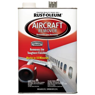

Rust-oleums aircraft remover

shit works better then expected, removed the clear coat on some stock rims.
it's a gel (more effective than the aerosol), you brush it on, listen to it eat at the clear coat for 10 minutes and pressure wash it off!
don't get it on your body, if u do just rinse off with water quick, it burns!
